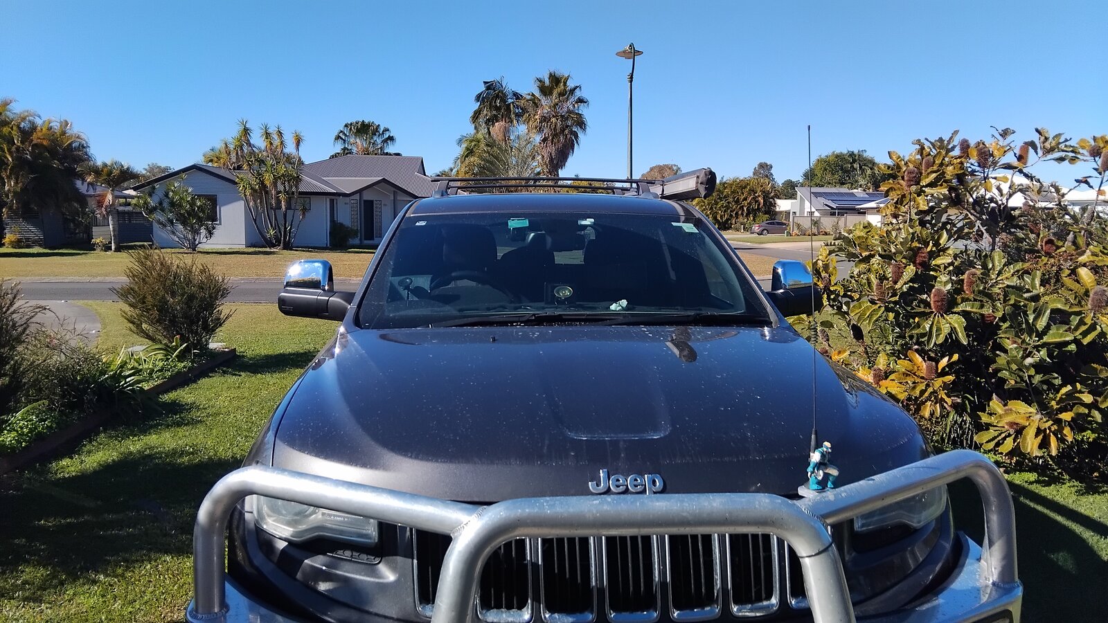

Recent run I got the sh*ts with my towing mirrors, I suppose being 10 yrs or so old they are finally wearing out ............ So stuff it, MSA was having its EOFY sale so I ordered a set, no power fold... $881 delivered now special is over its over a Grand ................ no stuffing around any more...........
The MSA aren't like a set of elephant ears and don't seem to block the view as much as the originals, give a better view as well....... Kept my old ones all packed away, I could sell them and cover the cost of the MSA's ....
