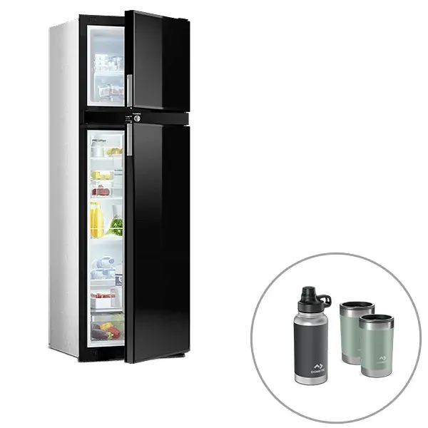

Thanks for the link. So if I’m reading this correctly, for the fridge ill be getting
Average energy consumption at AC (EN62552)1.02 kWh/24h
Is 1020 watts divide 12volts equals 85 amp hours per 24 hours.
rags
The Dometic specs on my generator confirm the power draw as 3 Ah/h
Avg Power Consumption1.02 kWh/24 h (240V) | 3.0 Ah/h (12V)

I converted to a compressor fridge nearly 2 years ago and can say it has been the best improvement I have made to the van hands down. Although ours is only a 110 lt dometic with average power draw of less than 2amps. Match the battery and solar to consumption and your in business. For me that is 280 amps in battery and 320 watt solar. It has pretty much kept the fridge running non stop for whole time it has been installed.

The fridge wouldn't draw all that (85a) as it wouldn't be running constantly but even at say wanting 60 amps all up on a hot day add to that 50amps for just general use that shows 110amp needed for a high use day........ I would look at seeing if you can up the battery storage even though they charge a heap for a battery.
So if you are going to do long term off grid then you will certainly need extra solar on the ground so you can suck as much sun a possible, you just have to remember to be economical with power, charge phone once a day usually midday that sort of stuff... but I would sort that out later when you get more familiar you have a good basic set up but would change to 120amp batteries or more if possible.

Things have changed a bit now the way Dometic now quote power consumption specs. They now list the fridges kWh consumed over 24hrs at a specific ambient temperature, 32deg, taking into account cycling, so the figures quoted for 24 hours is now supposed to be pretty accurate. Maybe they had too many people whinging about the confusing numbers they used to throw out

I looked at their 3ah but if its really 84a/24 based on a 24hr run then thats a lot of storage needed just for fridge. Plus the usual....
