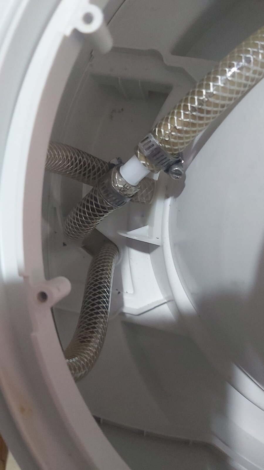

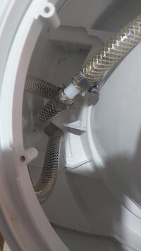

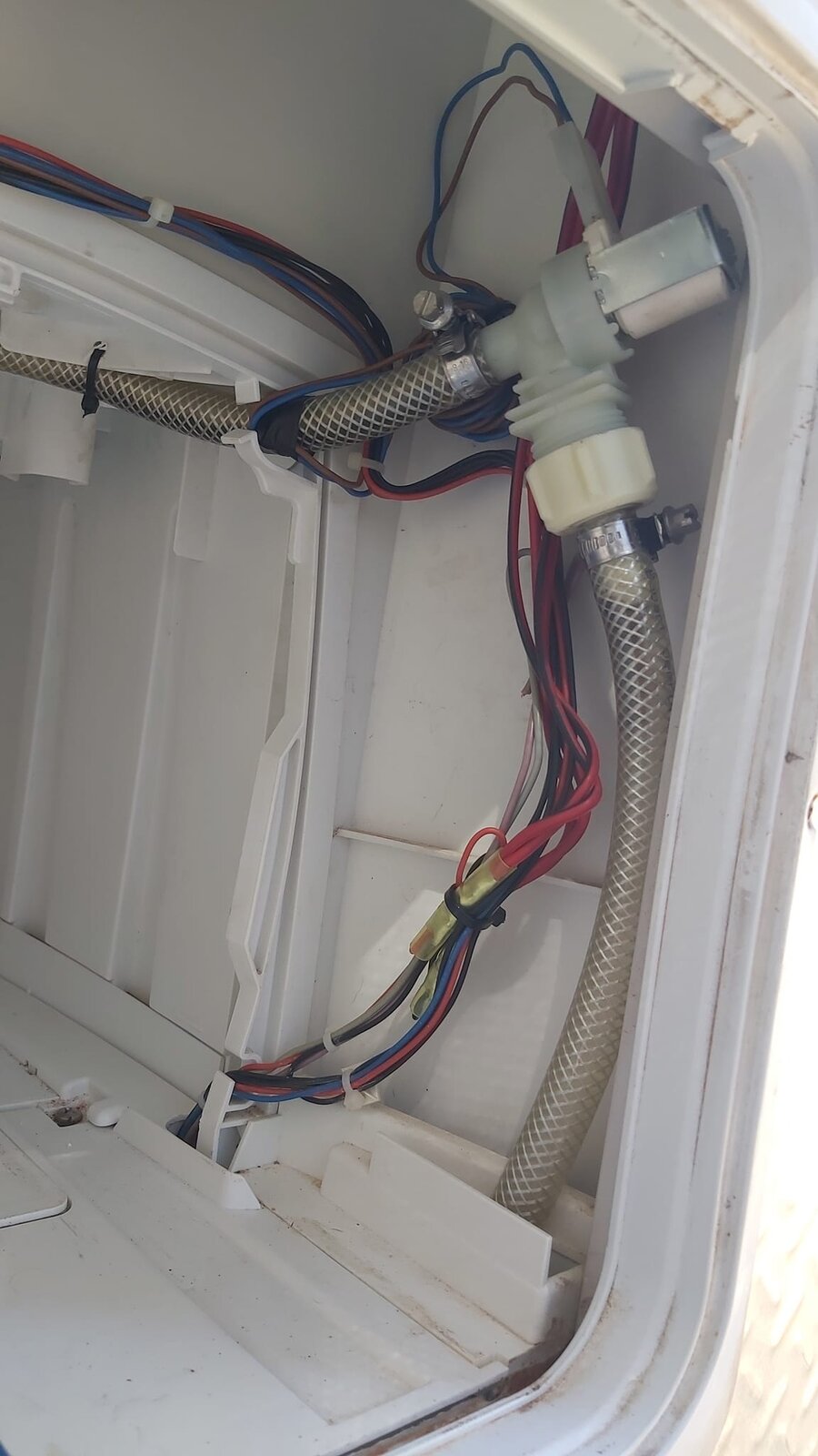

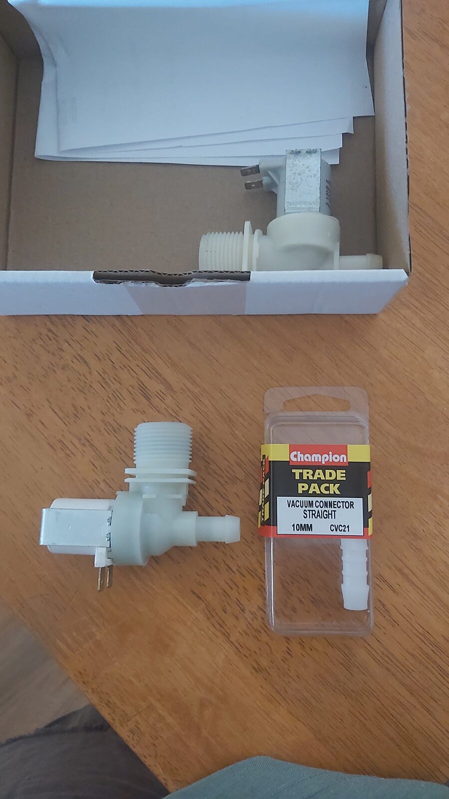

After a incident where the solenoid jammed open , I fitted a isolating valve in the supply water line under the floor.

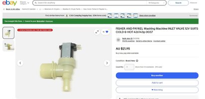

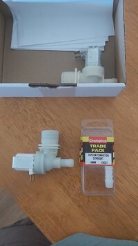

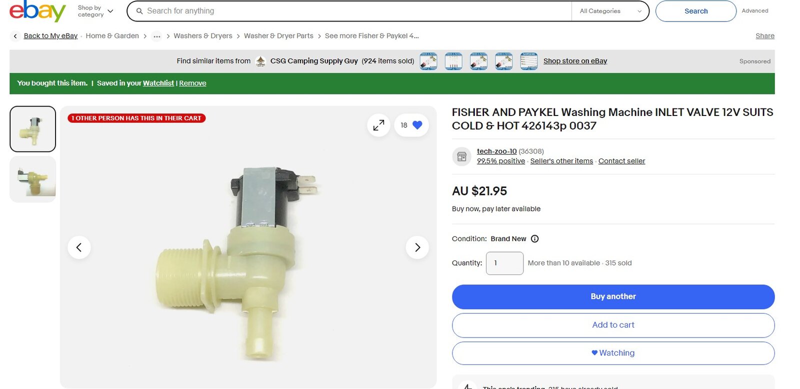

On a side note , if your toilet is a Thetford, the solenoid valves are the same as a Fischer Paycal 12v washing machine solenoid and are about $25 on ebay instead of the $80 that thetford want. When replacing it I also moved it from under the bowl and mounted it just inside the door. Why they designed it so you had to dismantle the whole bowl assembly to swap valves is a mystery.

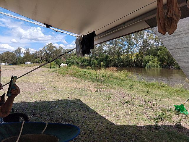

Today by the Gwydir River it got to 36c, tad warm but nice breeze and feet in a bucket of river water kept things pleasant, river water temp is about 14c, frost bitten toes...................... the magic thing is great proof my 3 way fridge mods are very successful ............. Freezer minus 19.6c, fridge is 7.2c, thats after some beer grabs, my original insulation upgrade worked and the recent fitting of 2 x 100mm fans on the top vent replacing the 75mm jobs, they really pull the air out ................. its nice my theory is proven ........

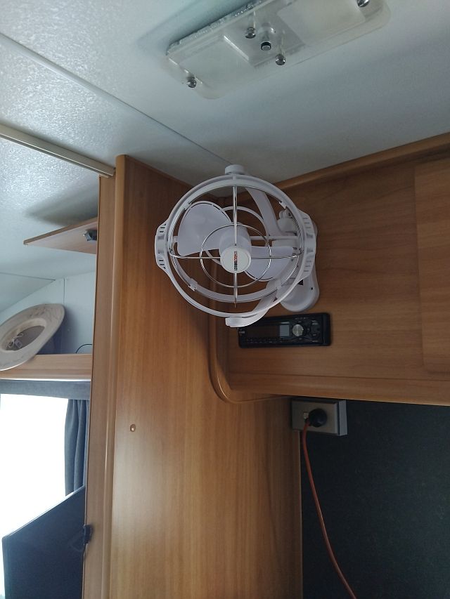

I also picked up a new fan for inside van, its really a Sirocco knock off from BCF, looks the same just a bit noisier but $100 less I can live with that and today they both are getting a workout............
Bingara7.jpg ... our new travel mate Rosie ..........Bingara6.jpg.. why we luv it here. plus the best bakery...

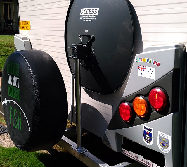

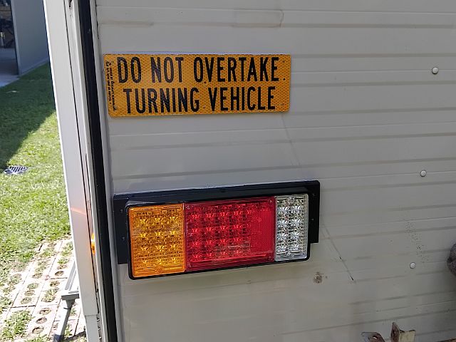

If you were driving down the road during the day and came up behind Big Mal you would have been hard pressed to tell if the tail lights were working, while original led's they were rubbish, okay at night but like an old Morris tail lights in daylight, been an issue for years, well not anymore the back has been tarted up, new lights with mountings fitted, I repurposed the casing of a household Invertor that I scrapped was just the shot, old wear marks to be artfully disguised in time .......... only been on the Roundtuit list for nearly 10 years...............
IMG_20160325_135849.jpg.. old style 3 leds per light .................................. new style heaps of leds..IMG_20260219_103230.jpg

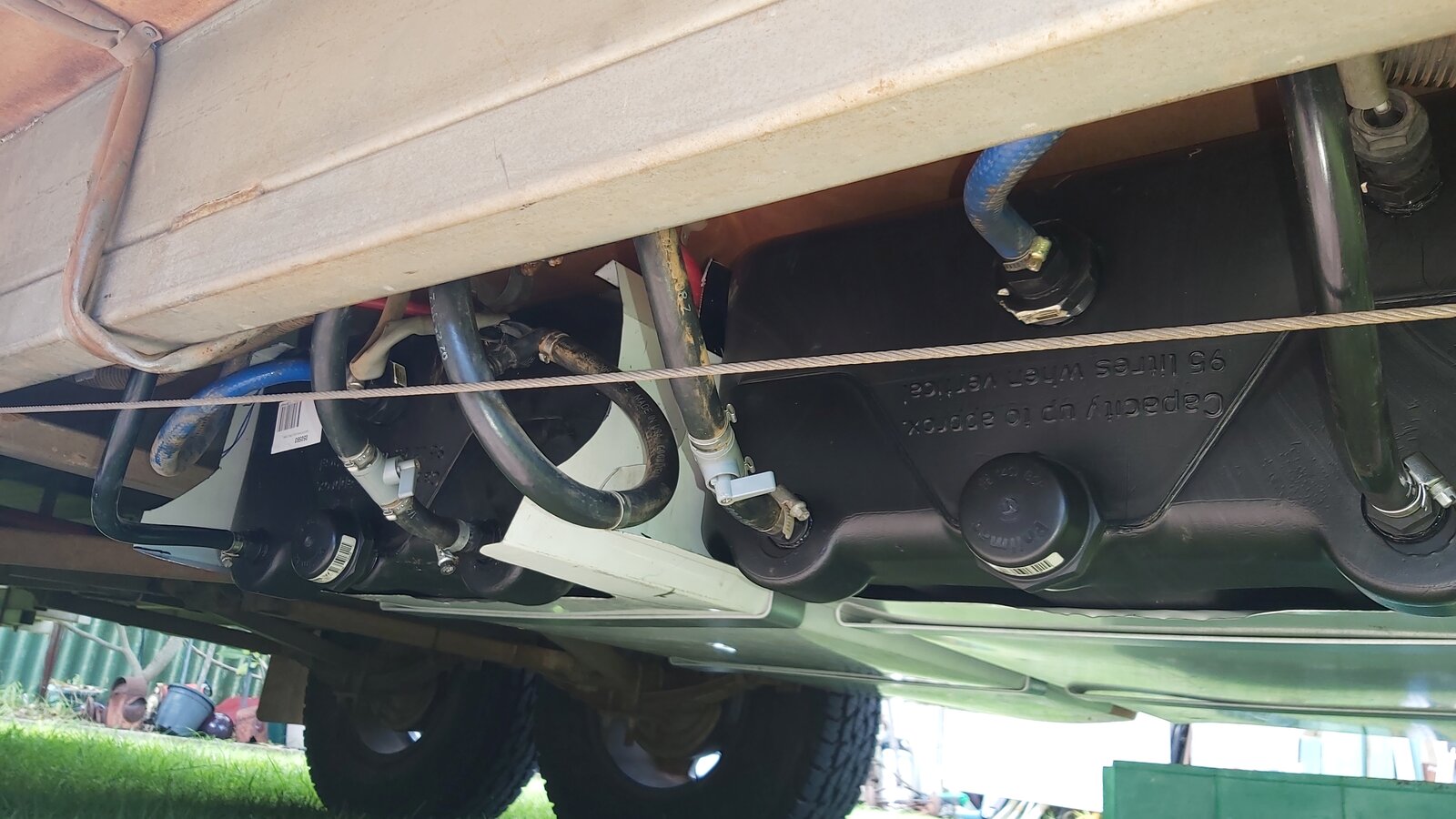

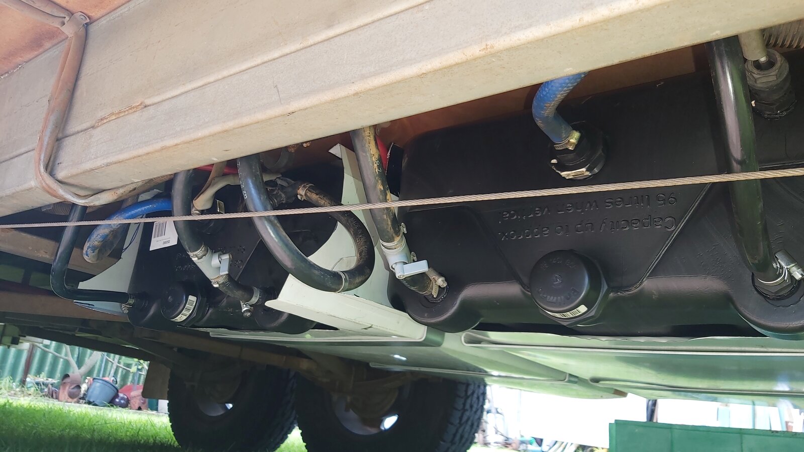

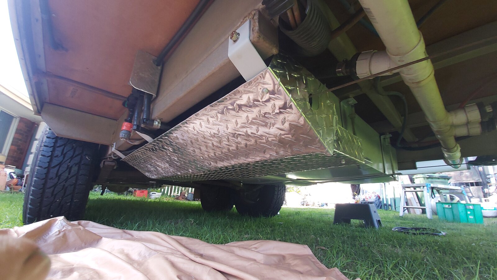

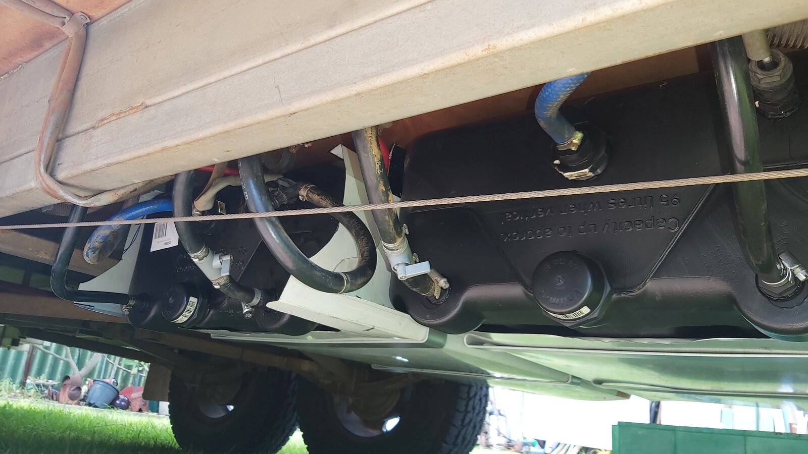

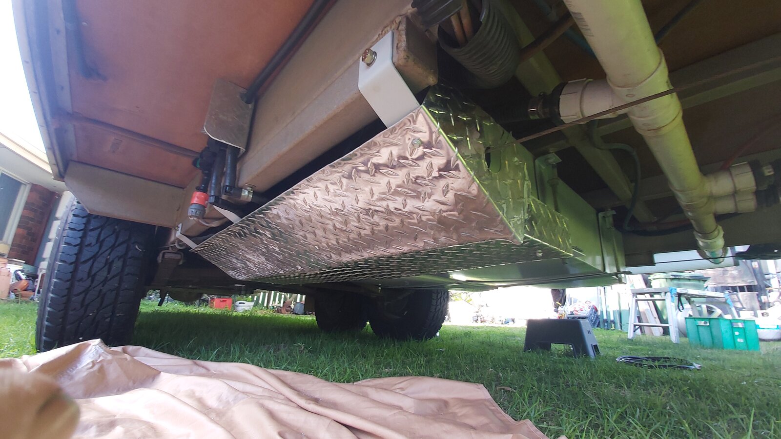

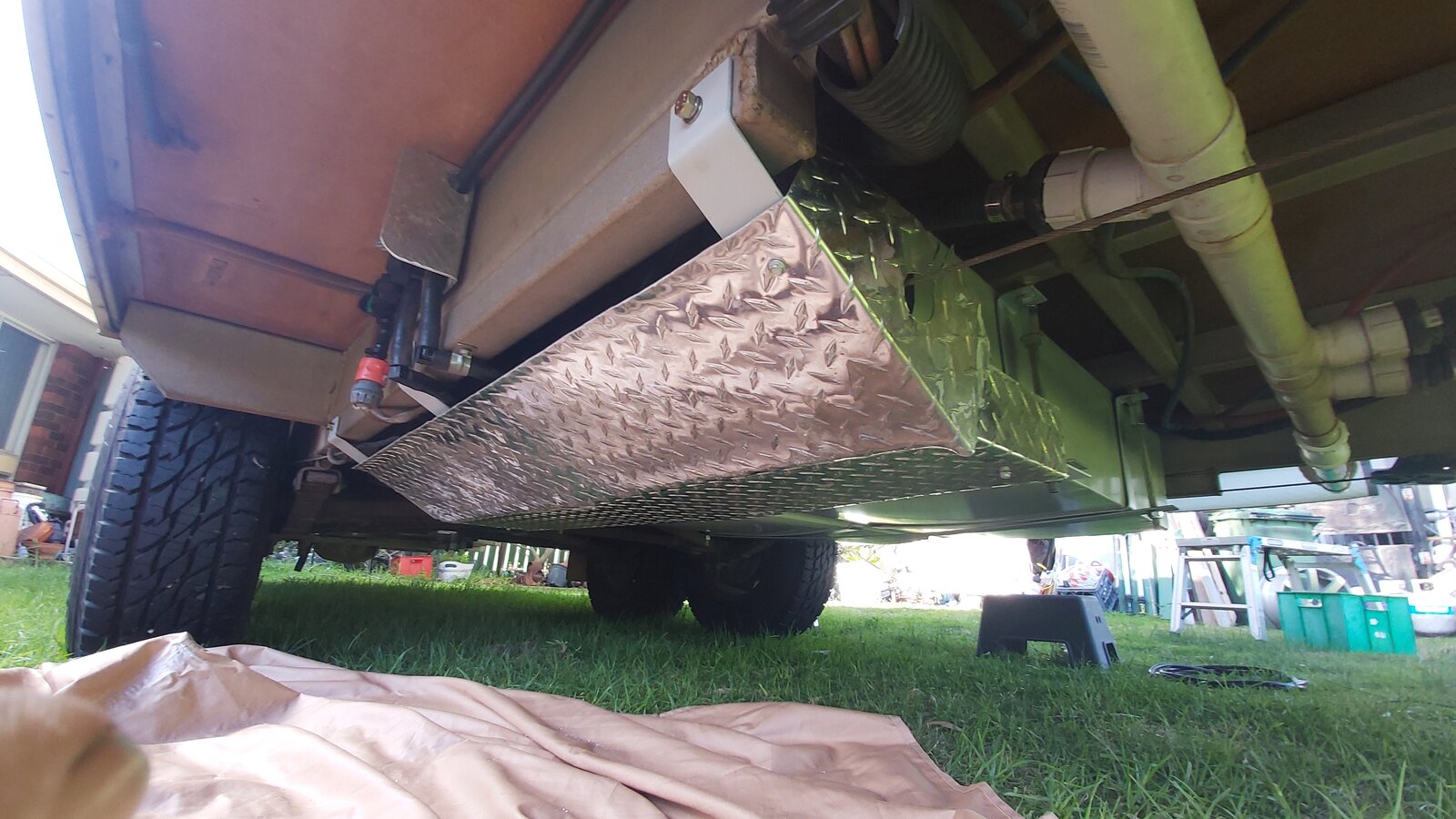

I fitted 2 x 95L tanks under our 2010 Coromal 615xc, replacing the 2 original 58L tanks. 95L tanks from Camec are same width as the old ones so will fit to original mounts. View attachment 70207View attachment 70208
will the extra water effect your on road preformance,extrs 90kg of water plus extra kg for the bigger tanks, will be great to have extra water when needed as water always runs out first
13,312
20,124
Thats a nice set up @Sparksy very flash extra stone guard, mine are a tad battered now ........................ I like those tanks might have a look for them, seem far better than the original 70lt Coromals I have
If I added an extra tank to mine it would be empty when on road, I usually travel with just one tank full, fill up in town before getting to camp or from Rangers 60lt tank which I have to ferry supplies from town, even though when back of beyond I fill van tanks, have full Jerries and Rangers tank full from last town I don't think I would fill the extra tank on van that would really be too much then .... Just a long time thought bubble at present and since it means laying on my back doing some welding probably stay a thought .....
Always have at least one tank full, pays off if road closed for accident or Fires etc sit back make a brew.

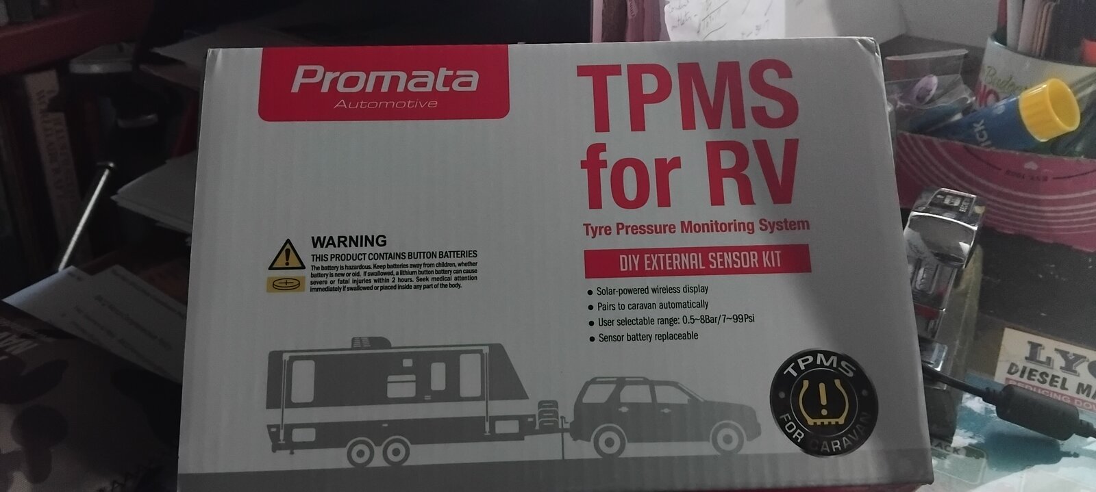

Hey Ian
What TPMS did you get?
My van is 8 this year seems like I only bought it yesterday and the Everest is 3 soon as well, bluddy time flies as we get older!!
13,312
20,124
Dave, gee time flies doesn't it ............ Doesn't seem that long ago you went to the dark side with the Everest...
I bought a Promata TPMS kit, 8 sensor system from SupaCheep, on their Tuesday night special deal, ended up saving $86 on the price so well chuffed ............. it was listed at $329 with the range extender, thought I may as well get one with it as the kit without was $319 but not sure if I need it as it picks up the van wheels from in garage but will do an easy wire up to see next trip ................. Ordered on Tues night and on my doorstep Thursday... seems to be working well..
