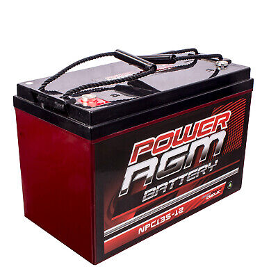

Definitely prefer to use an AGM battery of at least 120 to 130ah as per links.
