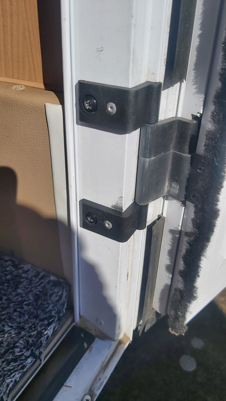

Hi guys, seems our bottom hinge has broken. I got a replacment however a bit confused how to remove the old one? There appears to be screws & pop rivets unless I'm wrong? Do I need to drill out the old ones & use a pop rivet gun ?

Yeh it looks like the rivet needs to be drilled out to remove the old piece of hinge, when you replace it just paint the head of the new rivet with a niko pen or black paint if you have some. Also don't put to much pressure on the drill, would hate to see you go straight through the wall.

New hinge was less than $20 delivered.
Ended up only replacing the top and bottom sections that attach to the van itself. Saved having to drill out all the door rivets. Just the 2 on the door frame. Have to colour the heads in black now.
I did also trim down the rubber stopper. The door handle can now touch on the van but given there was already a witness mark there I'm not overly concerned. Thinking I'll cut out a piece of 3M film or similar (automotive protection film) and put in the spot.
